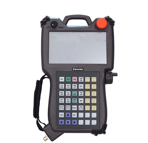

81RG Handheld controller
-Specialized controller for lathe Pick & Place.
-Comprehensive Pick & Place applications, quick implementation of automation.
-Easy conversational programming with low learning costs.
-User-friendly secondary development platform, satisfying a wide variety of applications.
-Advanced axis and IO control to improve Pick & Place cycle times.
-7-inch touchscreen with standard handwheel.

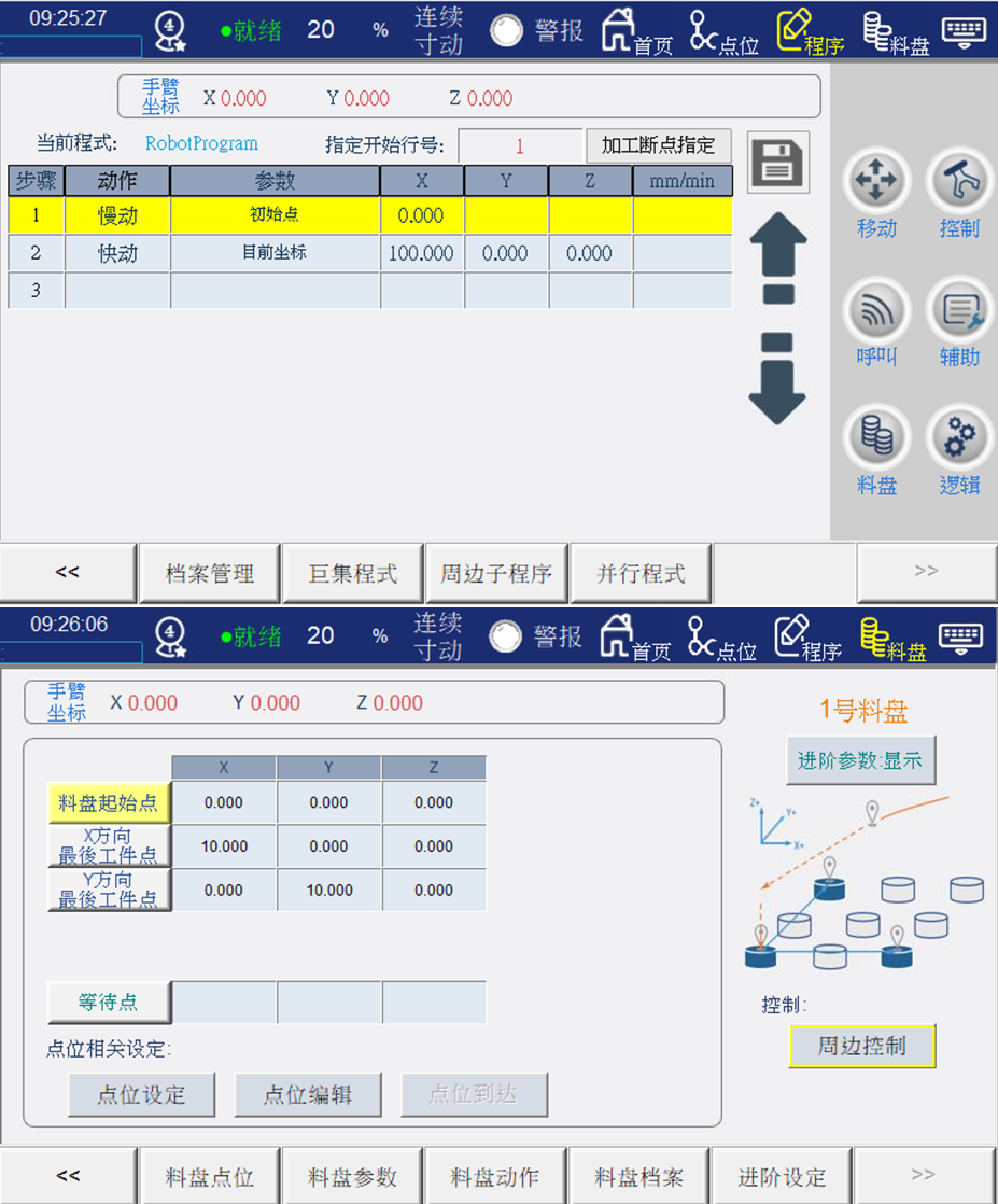

Pick & Place Application
-Parameterized matrix pallet, no need for repeated teaching point.
-Single-point and three-point teaching methods, flexible adjustment according to requirements.

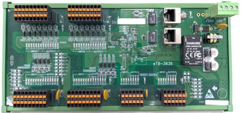

ETB3636 IO Board
-Supports 36 inputs and 36 outputs.
-Specifically designed for machine tools & robots, supporting both PNP and NPN connection methods.
-Utilizes EtherCAT communication, enabling flexible expansion of EtherCAT IO modules and servo drives.
-Pre-defined and segmented IO points for machine tools, grippers, material trays, etc., reducing wiring and setup time.

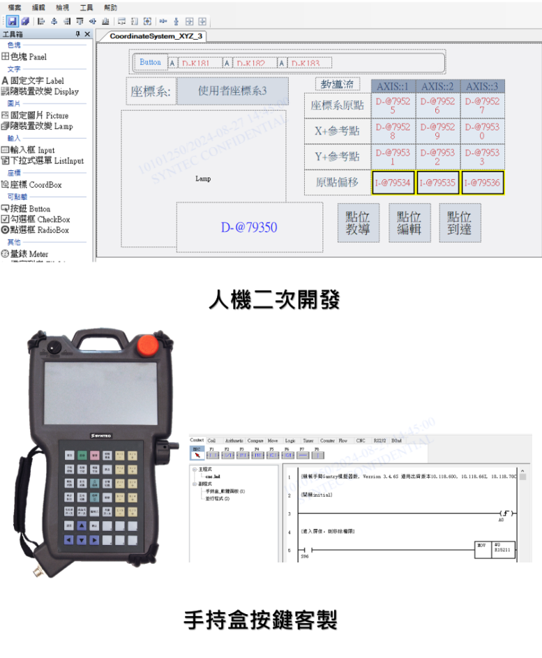

User-friendly Secondary Development Platform
User-friendly secondary development platform Provides SyntecIDE software tools to customize PLC, HMI, MACRO, and handheld teach pendant buttons according to requirements.

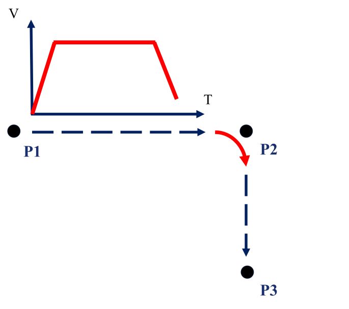

Advanced Axis and IO Control
-Continuing the tradition of SYNTEC CNC high-precision interpolation with smooth speed planning.
-Supports smooth path interpolation.
-Simultaneous Output and detect Input commands during movement.

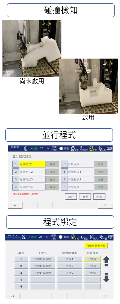

Advanced Applications Collision
-Detection Function: Detection of abnormal external forces and collision retraction.
-Parallel Program: Reduce the cost of writing PLC code.
-Program Binding Function: One-click switch of program files.
規格表
Model81RG PLUS
SupportedModelsGANTRY
OtherOptionsEtherCAT IOModule、FC IOModule、Syntec Vision、DA/AD Module
USBPortUSB*1
EthernetPort10/100Mbps*1
COMPortSRI*1
ServoMECHATROLINKIII、EtherCAT
Axes(max.)4(18)
